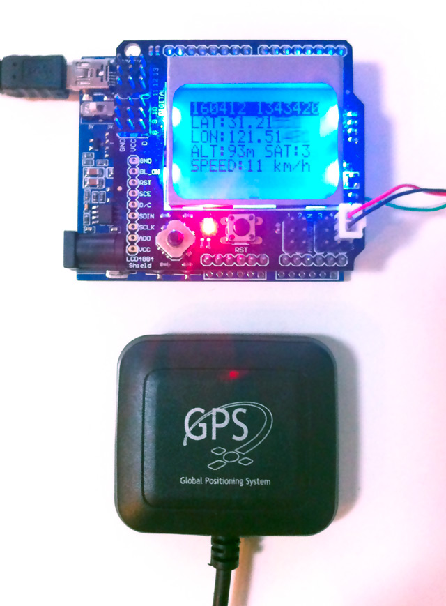

Most common USB GPS receivers come with a USB connector with a UART-to-USB chip built in. That means the GPS receiver itself provides serial UART output. So they can be used with Arduino by replacing it's USB connector with Rx/Tx and VCC/GND connectors. My practical test has proved that this works. What you need to make sure of is the baudrate of the GPS receiver.

can you share the sketch you used to read the tx/rx data from the gps receiver? i have one and would like to try this on my mega as a new user!
The code is nothing special, just using TinyGPS.
